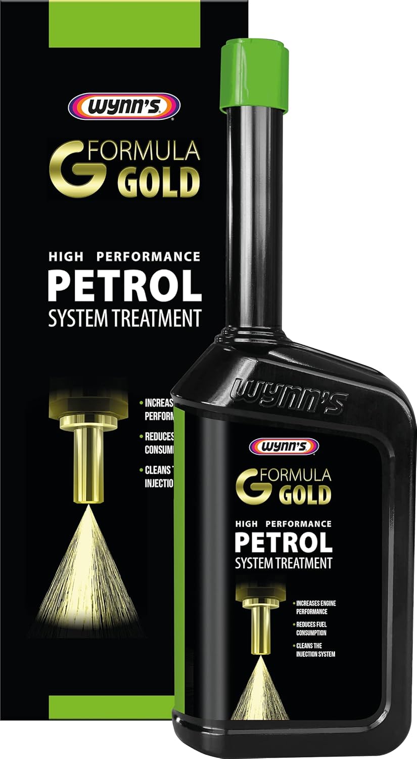

- If you are near shops for cars or bikes , please by this product below , put “ALL OF IT” inside the tank, (and use maybe half a tank or normal fuel to mix), now this liquid will travel all over your fuel system and try to clean anything that’s clogging up (funny revs can also be a sign the bike is “trying” to hunt for fuel to make stable revs or it revs higher from ECU to stop it stalling)

- Do not use Redex. Only this product is my recommendation.
